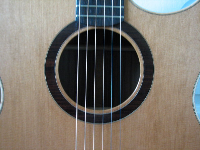

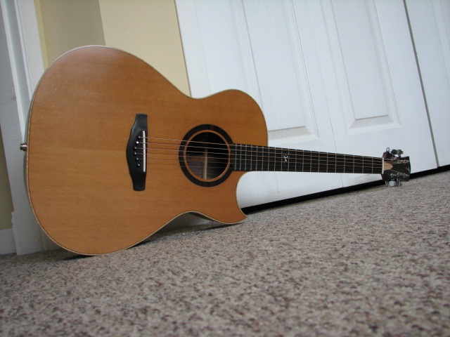

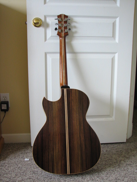

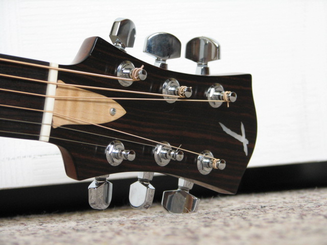

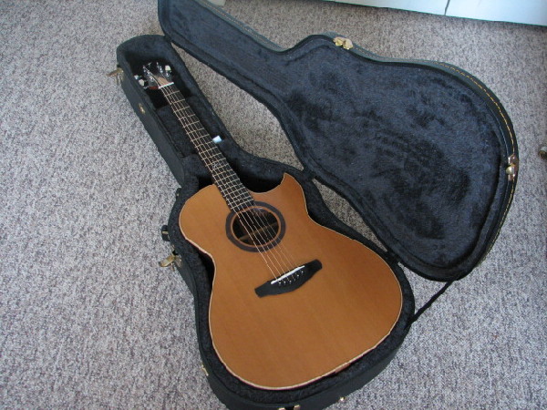

Well, here it is #4 heading out to my friend tomorrow. This guitar is traded for a website, design and update by a good friend of mine.
Intro:
EIR Back and Sides, Western Red Cedar Top, Maccasser Ebony fretboard, bridge and head stock veneer, 5 piece laminated neck Honduran Mahogany, Maple, Rosewood, single action truss rod (adjusting at the nut as you can see), flamed maple binding with b/w/b purfling on the top, EIR rosette with b/w/b purflings lines, standard Schaller chrome tuners, MOP headstock logo and customer signature at the 12th fret.
Finish is mohawk classic instrument lacquer over bulls eye premixed shellac.
Dimensions: 16" lower bout, 11-1/2" upper bout, 9-1/2" waist, 20" body length, 25.4 scale, 4-1/4" at the tail, 3-1/4 at the neck joint.
Firsts for me:
Pearl inlay work, the entire finish job (that I am happy with).
Things i'm realy pleased with: The body mitter at the cutaway, the signature (95% satisfied), the finish (95%, to chicken to try high gloss), the playability and the sound.
Things i'm not so please with: well, I'm not telling.
Thanks for looking

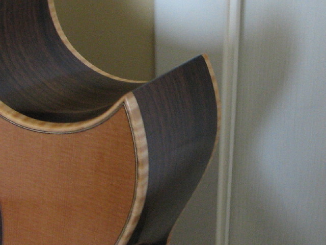

Beautiful work Rod. How did you meet the cutaway so neatly with no binding ? I love the guitar

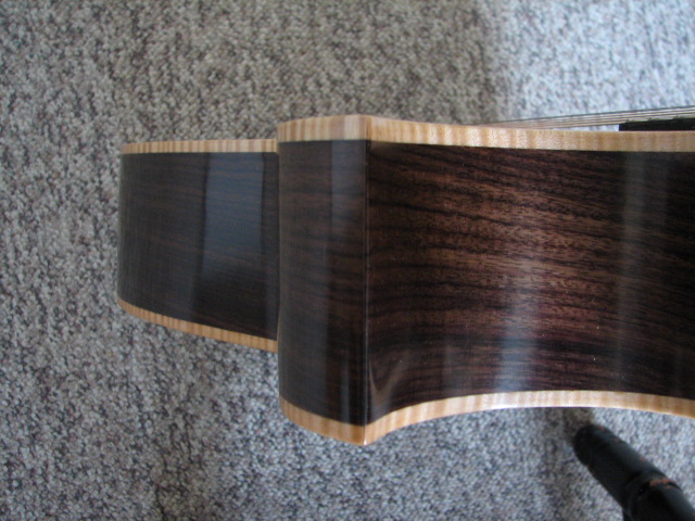

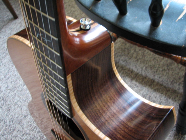

Hey thanks for all the kind words friends.

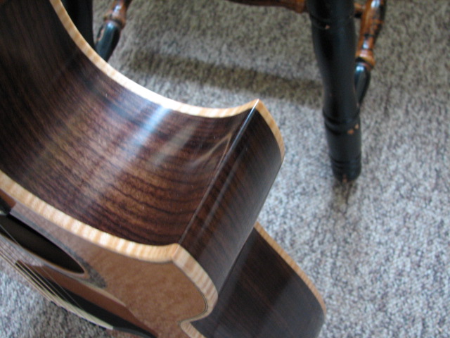

Craig, the cutaway took some fine work indead, I just worked realy slowly at it on the sander, little bit here, little bit there till the mitter worked, than I touched up the cutaway side on the pipe to make it fit the headblock. The nice thing about rosewood is that seams are hidden easily. Just try this with Maple, Ha, not me.

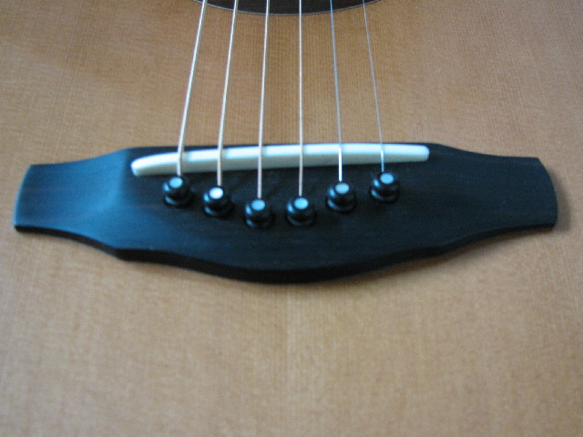

Here are a couple more pics of the cutaway and the bridge (which I can't take credit for as it is too similar to Kevin Ryan's and James Olson's, good company there thought eh? )
These are my favorite pictures of the cutaway, you can see the bookmatch is pretty good at the joint.

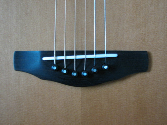

Notice on this last picture that the saddle is dead flat on the top. I have not done a final setup yet, but it is very well intonated so far (very nice surprise indead). I am letting my friend have it for a week or two, than I will do the final setup.
Thanks again.Rod True38798.7654282407

WOW, that's so nice! Can you tell us how you made the side miter on the cutaway? That is just awesome.

Wow, that cutaway miter is awesome! Way to go! There was no room for error. None. Zero. Not with that style, and you nailed it!

OK, this is the first cutaway I've done with out binding on it (all 4 of my guitars to date have a florentine cutaways). So, from memory here goes, I don't think I have any pictures, I'll take some the next time round cause I have another customer who wants a cutaway, I can't seem to get away from them .
Some terms I'll use before we start.
"Cut away long side" the long side piece running from the tail to the tip of the cutaway.
"Cut away short side" the other side.
It's basically like doing any corner miter with binding, only your doing it with the side piece. You want to make this joint first, before you attach the head and tail blocks.
Start with the inside block, shaped to the profiles of the curves of both side pieces, you should lay this out on paper (cause we all know that the wood acts just like a paper layout right )
Now, take the cutaway long side place it in the mold with the waist located correctly and markout where the tip of the cutaway is going to be on the inside of the side. Now I take the cutaway short side and lay sit it on top of the tip of the cutaway to help layout the miter angle, make a mark on the outside of the long side where the top of the cutaway will be. Use your square and draw a line down the side. Now you have two lines on the side, one inside and one outside. You can join these lines accross the thickness to get an idea of the angle of the miter. You all with me so far?
Next I take the long side to the sander (I use my thickness sander as I don't have an edge or belt sander) and sand in a rough angle, close to the miter angle for the cutaway. Check the inside and outside lines often as you don't want to sand through one, just close to them both.
So once you have this rough angle sanded to the long side, do the same with the short side.
Once the short side is roughed in, check the sides and inside block to your paper layout. Now you can start refining the angles getting them just right. Like any of the miters on the guitar, you want to go slow and take a little of at a time to make sure you don't have a Homer moment (Doh!) and trim to far. It's always easier to take off the material, it's much harder to put it back without anyone noticing.
When you have the miter where you like it, you want to glue up both pieces to the inside block all at once. Using Bruce Dickey's florentine idea or something similar, here's James Olson's
Clamp the two sides to the inside block. I made my block similar to James' and Bruce's so I could use cam clamps and clamp both sides at once.
Than you should have a nice clean joint once the glue has set up. As I said, gaps in rosewood joints hide very well with sawdust and CA, so don't worry to much about gaps, of course you want as few as possible.
Now you can touch up the short side on the pipe if you need to, but if you've bent the pieces to your paper layout, you should not need to.
Now your ready to glue in the tail and head block as well as the other side.
Few.... I hope I haven't scared any of you away trying this out. It sure is rewarding when it turns out.
Don't think I would try in on Maple though as that seam would be very hard to fill any gaps.Rod True38798.9309953704
